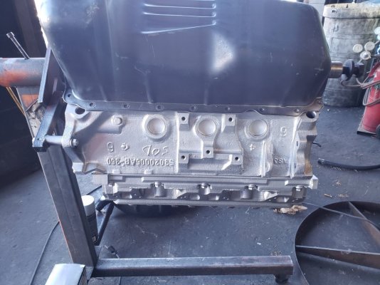

I bought another motor, a nice old used motor, however the 2002.... uses 4 bolts on the motor mounts, and the 2001 and earlier only has three. I had to buy another motor.

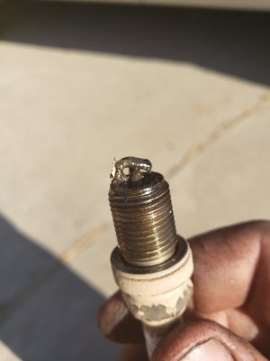

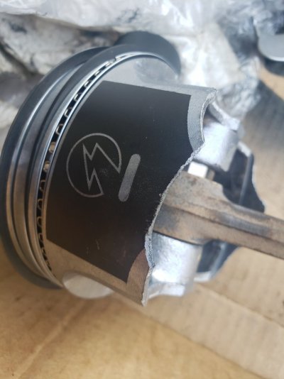

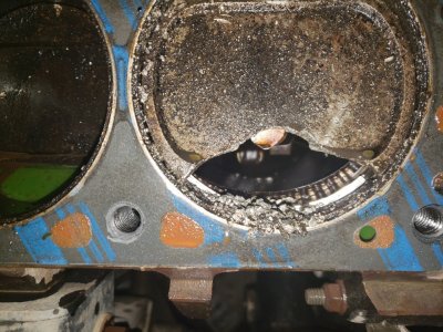

Here are the first photos. The damage as it unfolded.
1.) Spark plug...first indication of what was going to be found.
2.) valve cover off, nothing seemed out of place.
3.) intake off, found piston pieces in the intake runner of the head and intake manifold itself.
4.) and 5.) much larger pieces of pistons were found in the lifter valley. (Death Valley? muahaha)

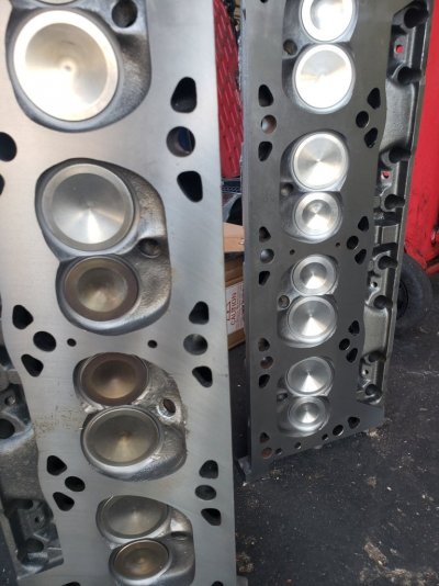

1.) Looks like I'm going to need a valve job LOL!
2.) Someone call the vatican and let them know I have a "hole-y" piston..
3.) Pretty interesting how this piston broke.. I still see oil rings in there.
4.) more piston in other cylinders.

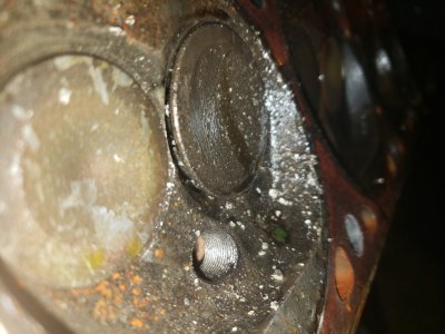

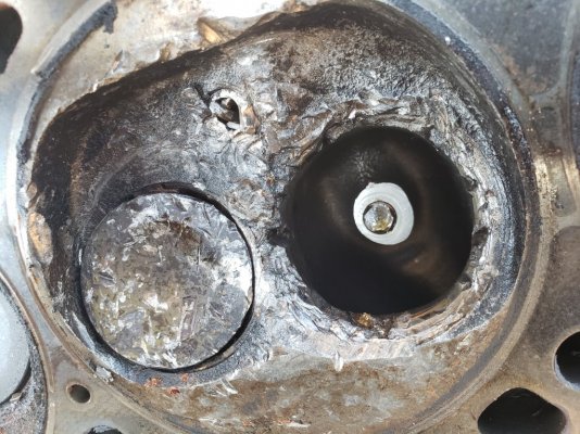

Well a year later I finally got the courage to pull the head off the drivers side Looks like there was an inclusion in the intake valve on #5 and it fell into the hole and got chewed up pretty bad.
If I had the finances I would grab a set of aluminum edelbrock heads and let her eat but I'm on a budget these days (stupid rona virus)
My machinist said he can fix the head, and said it would hold up at the power levels I'm running. I'm a skeptic, but we will find out soon enough.

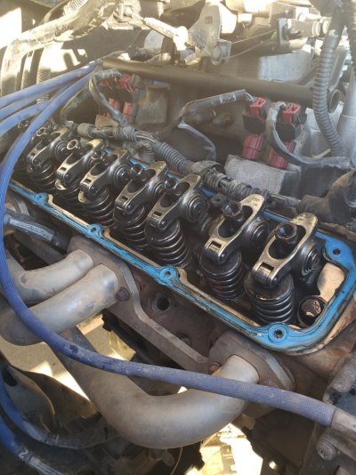

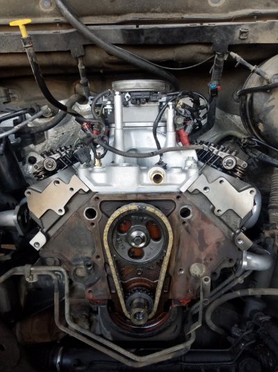

Here are a couple of random photos I found.
1.) My motor after putting the Indy heads on it.
2.) The rockers exposed when I was first trying to diagnose why it died.

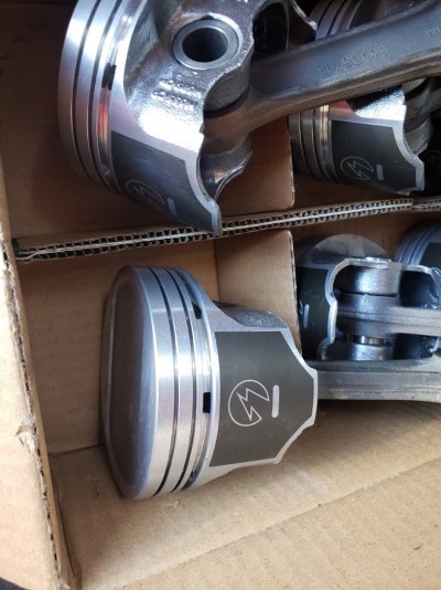

Things were going well with assembly until someone decided to fall from a high place..... FML. weight matched piston sets are only sold in a set of 8.... 3-5 business days....

I made the exact same mistake when I bought the new engine for my 02, ended up with one that had the three bolt holes. I thought MINE was bad, I had three rods with spun bearings, 2 broken off, one hanging about 2 inches out of the oil pan. You win.

Head was trashed pretty badly, but modern machine shop got it in working order. We determined the actual failure mode here... The valve guides (the softer ones that were put in by a company that I won't name out loud.) were so loose you could rock the valves back and forth in the bores when the springs were off.
The guides basically fell apart, and caused a stuck valve... normally this would have bent the valve, but this valve had a small inclusion in the material that would have been quickly picked up by an NDI X-ray type of QA. So all the valves were checked via the NDI x-ray process and SEVERAL of them had inclusions and needed to be tossed. We saved what we could.

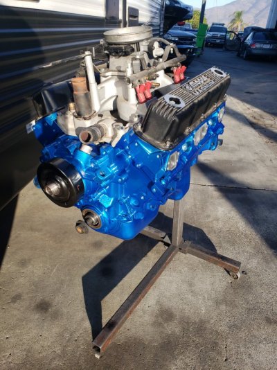

Tossed out the cheap timing set and went with a billet set. Got it all assembled and prepped and started on the base coat for the engine enamel last week.

Nope, I didn't even bother. I knew better. I ordered this block from fleabay. I bought it as a running engine... let me tell you for $800 I got hosed. the holes were full of water, and the cylinder were rusted and pitted. The block had to be punched and honed to make it work. REALLY disappointing what they sold me. Accurate is a damn good machine shop, but could not help me with my woes on this one.

Here is some post paint pics from this week. Even managed to spray a new A/C compressor to match. Have been thinking about tearing the alternator down and spraying the case on that too... but too much work, and I want to drop the motor in this weekend... it's been 15 months, I need my baby back.
