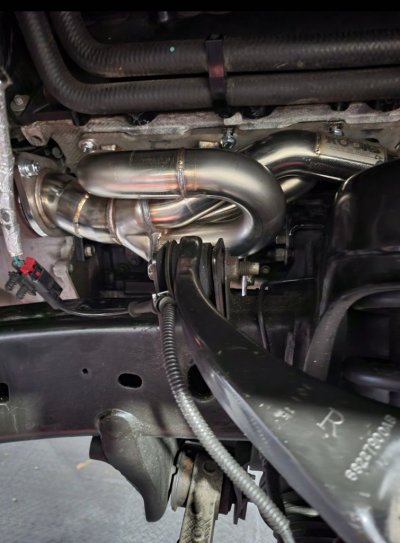

I installed Kooks shorty headers with remflex gaskets. I love them on my truck. you do have to lift the engine a little bit but it's no big deal. Don't go cheap it's not worth it Kooks are stainless steel are top quality and use remflex gaskets they are the best
