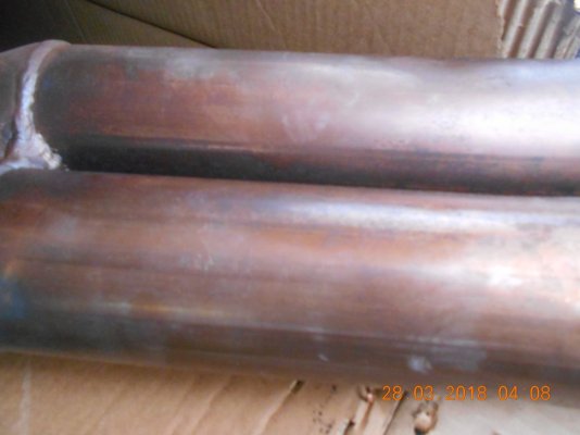

Wrapping them with header wrap will make a noticable differance in under hood heat. Even if you think the wraps not a good idea,which is an old wifes tail,i'd rather replace a set of headers every 10 years,then fix underhood wiring / hoses etc,every few years that degrade from the heat the headers radiate.You're call,but underhood heat kills wiring / hoses etc.,so anything you can do to reduce it,usually works in your favor.
It's also a great way to trap moisture in there and have them rust out
Jan 17, 2016
23,650
54,305
14 Sport
That's an old wifes tail.Any moisture in the wrap is going to evaporate with-in minutes from exhaust heat.
My JBA midpipe after being double wrapped for years,not really even any surface rust.
My JBA's are 10 years old,and have been double wrapped right from day 1,and they're still in pretty good shape yet.

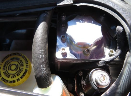

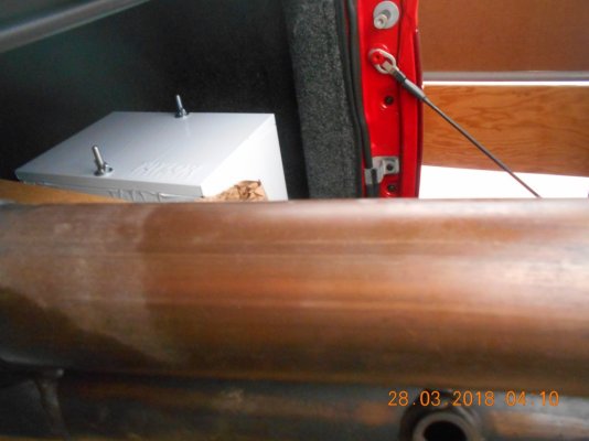

I don't really have any reservations regarding header wrap, just not something I care to use with Header Armor and Jet Hot coatings offering much longer lasting results for not much more money. The thing is, people I know utilizing either are running FBO long tube 500hp+ applications or are boosted (and everything is wrapped or jacketed anyways)
So I'm curious if the ceramic coating or HA is overkill on such a low output NA motor. I understand the larger surface area of the shorties will increase under hood temps, but seems no one on any platform has ever reported by how much.
The long tubes on my wifes 6.4 Challenger are both coated and wrapped,and you can put your hand on them when the cars idling,you can't do that with just a coated header.Even on my trucks long tubes which are 10 years old,and the wrap has degraded some from new,i can still put my hands on the primaries when it's idling.
I never checked underhood temps on the car,but the wrapped headers do appear to put less heat into my underhood nitrous fuel cell,then the factory shorties did,and it basically sits right above the drivers side header,right beside the brake booster,under the cowl.
