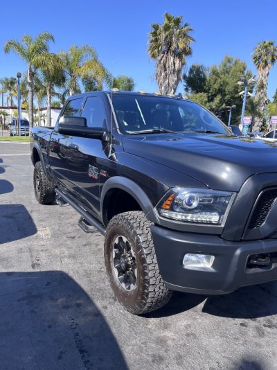

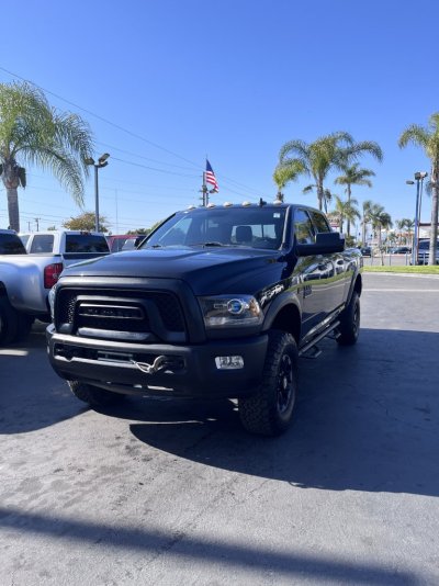

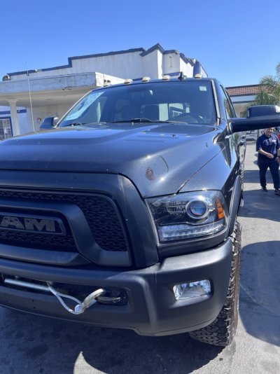

Hi all,
I’m looking at a 2017 PW that has 158k miles on it. They are selling it for $27k USD out the door. I’ll be using it for some travel trailer towing, smaller jobs, but also around town here and there. It drives beautifully and looks very well-maintained. CARFAX seemed to have regular maintenance on it.
I’m really new to Ram trucks, especially newer ones. Should I even be considering this truck since the miles are so high? How long will a hemi 6.4 last? Will I be most likely running into too many issues?
I’m looking for all the help I can get.
Thanks!

Like bmags said that’s not high mileage at all. I wouldn’t hesitate if you like the truck and the price.

I really appreciate everyone’s input - very helpful. Man, I love the look and feel of the power wagon - maybe that’ll give me an excuse to go off roading. But I understand that it was meant more for being off road than for towing. It looks like the max payload is 1,510 towing capacity is 10,030 for the 2017.
How close can I get to those numbers and still be safe?

What kind of travel trailer do you have in mind, that will determine what truck you need. The power wagon capacities are equal to a 1500 and you should stay in that category if you buy it, but it’s worth mentioning the power wagon will definitely handle a trailer better then any 1500, just not as well as a regular 2500.
If your ok with a trailer roughly 20-25ft, 7000lb I’d jump on the power wagon, sounds like you really want it and would get a lot of enjoyment out of it, you only get to live once

Realistically if primary duty is not a tow rig and your travel trailer doesn't exceed 7k lbs gross weight, you're likely fine with this truck. You just have to be realistic with your expectations. You can exceed payload by a degree if you must, as long as you never exceed rear axle weight ratings. I don't suggest it, but RAWR is more important than payload. mrack was pretty spot on with what he said with one caveat. 7k should be gross weight and not dry weight. If you want to stay within all the numbers there are tons of options.

You can easily go up to the those numbers. There are safety factors built into the those ratings already. A manufacturer is not going to give an official rating of 1,510 lbs. payload if you can only "safely" go to something like 1,300 lbs.
From my experience a PW handles loads better than a 1500! A friend has a 1500 that is factory rated to tow 10,000 lbs. just like my PW, but my PW handles the same trailer WAY better than that truck.
The only real difference between a regular 2500 with up around 14,000 lb. tow rating and a PW with only a 10,000 lb. tow rating are softer rear springs and the D-rated tires. I know "legally" you can't change the capacity of the truck, but if you swapped springs and tires with a regular 2500 I really don't see what the difference would be?
