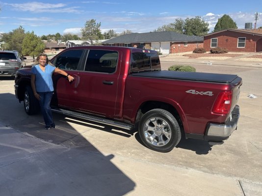

The saga has ended - or just started.
Stopped by the local ram dealer. Looked at two that didn’t quite meet requirements. Looked at and drove a 2025 1500 lonestar. Yep, drove it home.
4wd
Crewcab
5.6 bed
3.0L Hurricane
3.92 axle limited slip
Spray-in bed liner
Wheel to wheel side steps
1600 lb load
Bunch of other stuff, nice but I wouldn’t have chosen to pay for.
Minor verbal altercation with the sales manager that Dearly Beloved shut down before my bulldog mouth wrote a check my terrier butt couldn’t cash.
Price was okay/good, not great, not bad. I really don’t like paying for the depreciation for that first foot you drive out of the lot - such is life, don’t dwell, move on.
Very nice truck, extremely quiet. Acceleration is very good, considering the 3.92 axle and the rated horsepower - as expected.
Tires look a bit wimpy. But that was expected. We have had poor luck with the factory tires on our last three vehicles.
I only have 60 miles on it, however, looks probable it will fit the mission.
Thanks for the help. I’ll be listening in.
