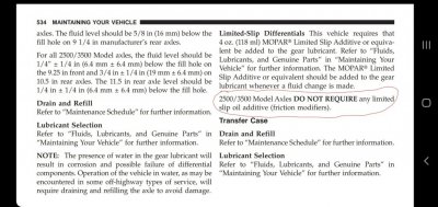

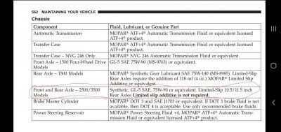

My 2010 has done the same since I bought it last summer. It seems to be the LSD. As mentioned, it doesn't take any friction modifier. In my search I have seen no OEM literature that advises friction modifier for our LSD, in fact it says that it does not take friction modifier.
With the OP's new gears, it makes it easier to activate the LSD than when he was OEM.

you guys realize the friction modifier is cheap and harmless to a rearend if not needed? i get that you don't understand why or that it does not make sense but what would be the harm of squeezing in a tube to see if it resolves the problem as per the mfgr recommendations? My dealership showed me the literature from the mfgr that clearly says add (part number) friction modifier.
I would like to see a copy of that literature. Also make sure that this was not for the 1500 series trucks that have a different differential and do require friction modifier.

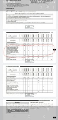

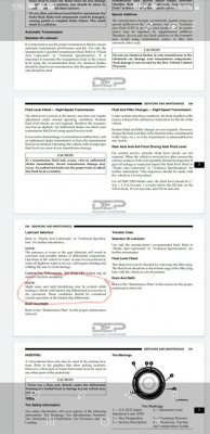

Looked up to 2019 manual. Everything has been addressed in it. If severe duty or towing, change the gear oil every 20k miles. It also mentions shuddering or vibration may be felt when turning on concrete or hard surfaces. It also says to add friction modifier now for limited slip axles.
Screenshot_20200630-155542_Gallery.jpg Screenshot_20200630-155554_Gallery.jpg Screenshot_20200630-155620_Gallery.jpg
