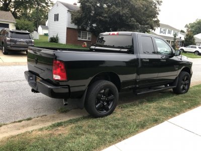

I installed a pair that I ordered for a 2018 model. They fit my 2019 Classic perfectly.
Same here. I have a 19 classic and installed side steps ordered for a 2018. There may be a few minor tweaks to little things, mostly electronics like the speakers you already discovered, but the major mechanical components, body, suspension, frame, etc..are all the same on the classic as other 4th gens. I also ordered everything for an 18 when putting on a front and rear level kit and everything bolted right up.

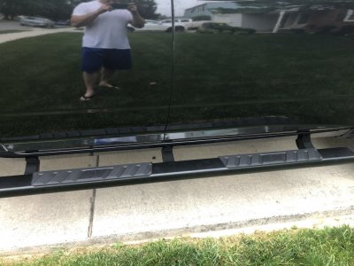

I put on tyger steps ordered from amazon and am very happy with them. As stated, these were listed for an 18.
