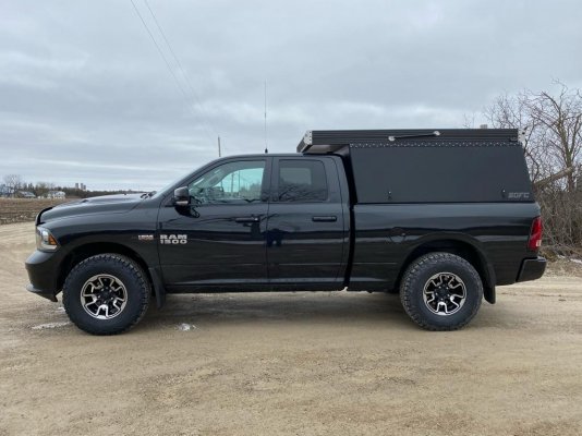

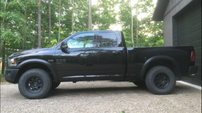

yup i think you’re pretty accurate in saying that. i too have noticed various measurments depending on how level the ground might be.
sorry for the delay on the pics as requested above...will post them hopefully tonight. busy as heck last few days.

yup. i think they are 34” or close to it.
Yea they are pretty much a true 34" tall per their specs. I've been eyeballing that size for a while but couldn't track down any pictures of them on a truck that was leveled up front with a slight lift in the back. They look about the same as my 315s from the side, and have alot less width. Thanks for the pics!

If you’re looking for another pic, I’m running 285/75r17 with Bilstein 6112 @2” up front and Icon +1” springs in rear.

I actually have a screenshot of your setup since it sits at just about exactly the same as mine. +2" front/ +1-1.5" rear. After today I'm just about 100% confident I won't notice the minor drop in size. My 315s rub alot at full compression in spots that I can't fix. I was worried the 285s would look small in these monster wheel wells, but that's just not the case. Both your trucks look great.
