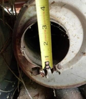

They must have changed the size of the pipes between 03', and 05'. Cause my 05' had 2 3/4" on it from cat back. Stock.
Here's my intermediate pipe. The pipe between the Y, and the muffler. The one folks normally put a cut-out in. Yes 2 3/4" exhaust pipe exists.

Must have, 3" on my 03.

What you don't recognize 3"?? lol Trust me it's 3".. I have the original muffler laying out back I'll throw a tape on it tomorrow...

I'm just joshin ya, man. Chill! :Big Laugh:
What I really want to find out is why they changed the diameter of the pipe? Maybe to pick up low end, or fuel efficiency? Cause my 2012 has 3" also.
