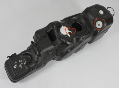

Definitely do the smoke test. You can buy a machine online (major online retailers) for $25-$100. I have been chasing down EVAP leaks for over a year and have replaced:
  • Gas Cap
  • Gas Filler Hose
  • Vapor Canister Purge Solenoid
  • Vapor Canister
  • Vapor Leak Detection Filter
  • Vapor Leak Detection Pump
Now I have found that the EVAP line that goes from the top of the tank to the gas filler neck, and the flange on the top of the gas tank for the fuel filler. Basically, I need a new gas tank since NO SHOP will fix a plastic gas tank. If I fill my tank up until the pump automatically shuts off, I get a nice big puddle of gas under my truck :mad:
