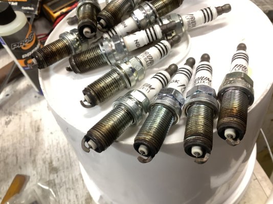

image.jpgimage.jpgI did mine for the second time and mine is a 5.7 with a tune due to larger injectors different maf and colder plugs,only 30 on them but here’s a pic of the electrodes and a slightly different underhood pic,no easier except maybe the air box.
