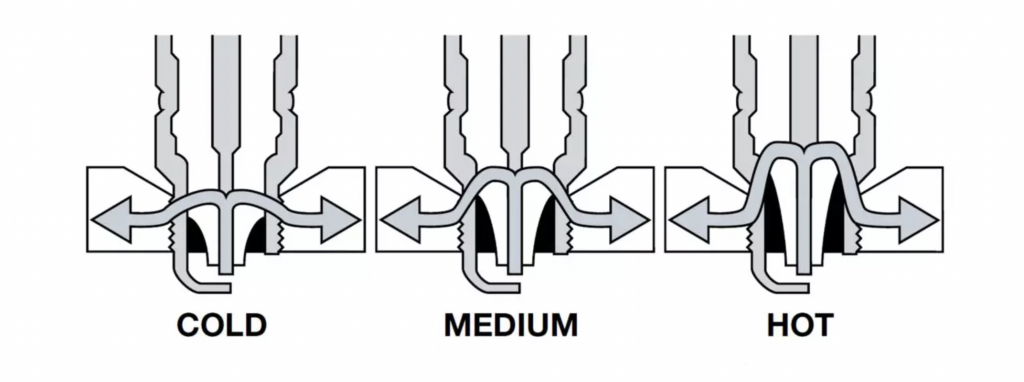

A hotter plug will have less insulation on the center electrode which allows it to get and stay hotter. That helps burn off the goo when you have worn valve seals and rings.

To add a visual to what Oliver explained above.
