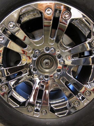

Try to find a hubcentric wheel if you can (hub bore approx. 78mm) or you'll have to buy hubcentric spacers for another $100. I also prefer single bolt pattern, too many holes in the wheel just bothers me (that's why they hide that under a plastic hubcap) even though theres plenty on the road
http://www.motorsport-tech.com/hub_rings.html
They can custom drill holes, rather than dual holes. It just costs $24 a wheel

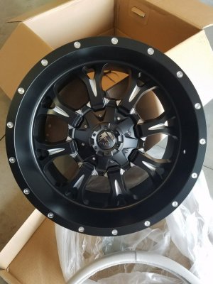

Its in your black lifted thread...fuel kranks
