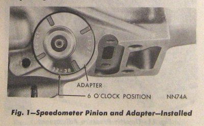

So I went with 40in tires on my Ram and I have to change the Speedo Pinion. I know I need a 27 tooth one which will get me close but where do I index it? The lowest index is 30. That's where im having trouble, can anyone give me insight?

When you say "index", are you referring to what position the gear and housing install in the side of the trans?
