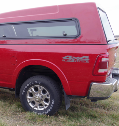

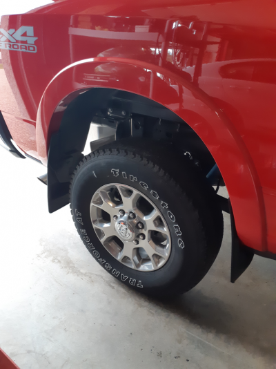

molded splash guards look like they belong on Honda CRV's not Power Wagons. Mopar HD belong on Power Wagons.

Per the pictures I posted, Putting the adapted flap on the front of the rear wheel well cuts way down on rocks and mud being flung forward. There is a thread I did on how to easily do that with a spare set of rear Weathertec flaps.

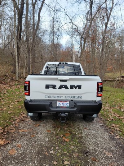

For my ‘21 I purchased these from myMoparparts.com 82215928AB Splash Guards, Front, With Flares 82215929AB Splash Guards, Rear, With Flares. I also picked up a rust inhibitor (recommended) and a plastic rivet tool (required) from Amazon.
I like them, they keep the gravel from tearing up the side of my truck and when I’m driving I couldn’t tell you a thing about them.
