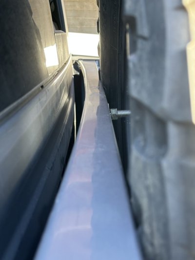

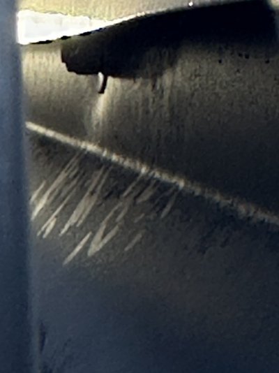

Had a scary moment when I was grinding the upper coil bucket/shock mount area to fit the shock reservoirs. I hit one of the hard brake lines with the grinder. It hasnt leaked but Im worried about it. Its one of the lines that comes off the ABS unit and its a single piece that goes all the way back to the rear axle. A quick recon says it will be a huge PITA to replace. I will likely do this for piece of mind. Be careful when installing shock reservoir mounts on the driver side of these trucks.
Here is a pic of the inside/top of the track bar at the axle end. This is beyond full droop, there is no shock installed. You can see the spring is dangling. The track bar clears on all sides. All of the steering components clear as well which was a pleasant surprise. I was expecting to have to put the axle back into the 1/2" forward position.
Here is almost everything back in place. The coil spring looks better than stock. It does scoot forward as the axle moves upward so I need to do some more testing to see if its going to be safe when fully flexed but for now it works great and drives well on road. It would be rad if someone made a completely new upper coil bucket/shock mount that worked with the axle pushed forward and fixed some of the coil bow. I havent looked too much but Im guessing it more work than would be worth it to try to cut and weld the lower bucket at a better angle. WTF was Dodge thinking with this design?
