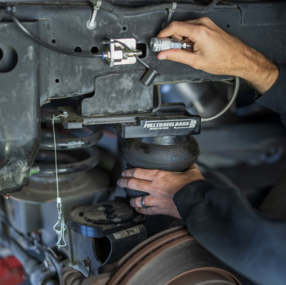

Next in line was airbags. Im going to be adding about 2500lbs to the back of the truck so I picked up these rad airbags from Full Travel Bags. (If you arent familiar, these are what CJC sells) They mount using a quick release for the air line and the bags so you can easily swap them out for the stock bump stops or aftermarket ones that mount to an additional sliding plate they provide. The bottom of the bag is completely free so you dont lose any flex and the bags have their own internal bump stops as well.
Here are some stock photos from CJC showing how the bags and bumps swap in and out. Its pretty slick, you dont even need to jack up the truck or take the wheel/tire off to swap them out.

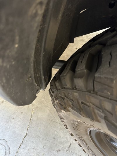

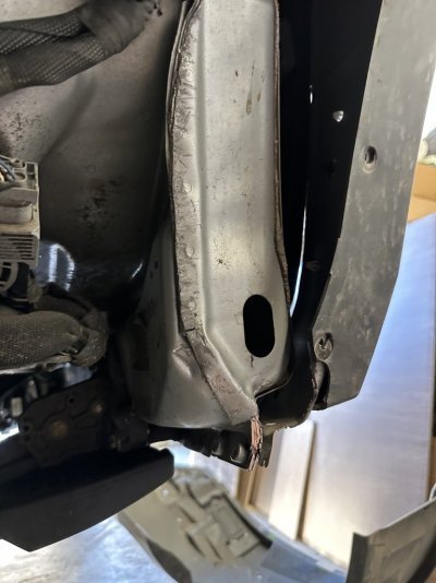

Did some minor pinch weld and fender massaging in front and now my rubbing is totally gone, even at full flex.
Before
After

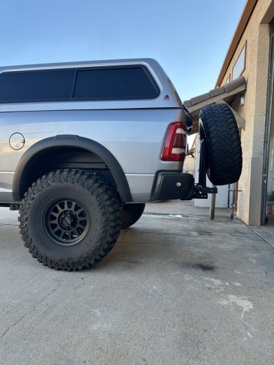

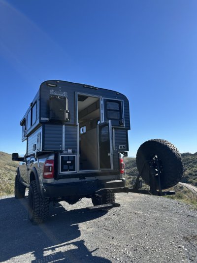

Threw on a Rig'd spare tire carrier so I could get the spare out of the bed. So far I like it. Definitely sticks out kinda far and reduces departure angle a little but not too bad. Also deleted the rear parking sensors and relocated the backup cam. Whats interesting is the rear cross traffic alert still works after deleting the sensors. Not sure how, maybe its camera based? Also chopped the exhaust tip to gain a bunch of ground clearance.

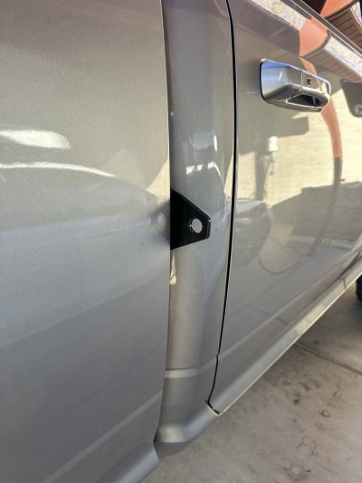

Installed Happijac camper tie downs. When the camper is off the truck the only thing you see are two small black tabs in between the bed and cab and then two small chrome tabs on the back bumper.

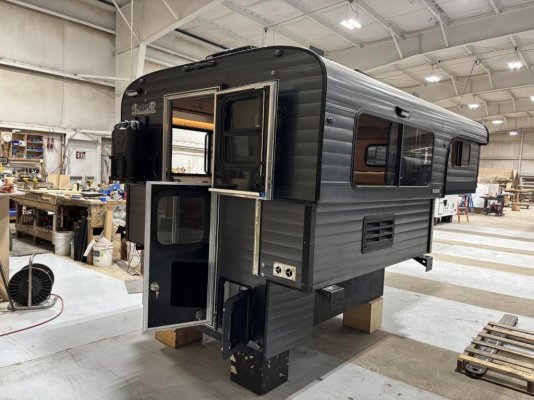

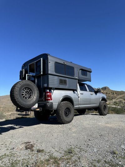

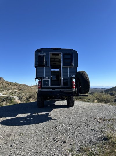

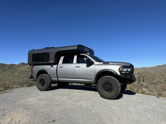

Well here is the true start of phase 2. Brand new Alaskan 650si. A few mods still to do to the truck and after the first few nights in the camper the list is already pretty long. Loving it though. Its the perfect middle ground between the RV and a smaller/soft sided camper. Dont worry that hitch step isnt permanent.
Its so fancy. Its so much nicer than our old rental spec Thor RV. Its so much nicer than really any other pop-up camper on the market, regardless of price, and its priced in line with most of them depending on how you spec it. It genuinely feels like a mini Earthroamer. The use of space is perfect, the lights are LED but warm colored and everything is dimmable. The whole thing is power including raising and lowering the roof and nearly everything is monitored or controlled via bluetooth. 12v air con, 324ah of lithium, solar and dc-dc charging, toilet inside, shower outside(by choice) all the trim is real wood, no fake laminate BS here(other than the counter tops, obviously not real granite for weights sake.) And I can install/remove the thing in ~30 minutes.
