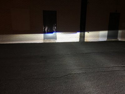

Light output is pretty good, nice colorful cutoff and wider pattern over stock. I will say the OEM projectors where brighter in the center vs the FXR, but OEM lost width quickly where as the FXR evenly distributes the light over the whole cutoff but with a less bright hotspot.

Site will only let me upload 1 pic from my phone, this is with the headlights and fogs on.

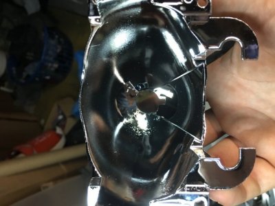

Called about the finish of the projector bowl and sent pics and they said that's normal.

Projector output is pretty good not going to lie, always a fan of their quality and effectiveness. The FXR is a nice projector and works well so I'm pleased. Not going to lie i expected alittle more and I'm noticing from the pics that the driver hotspot is alittle off as far as output goes but I'm more disappointed in how they worked out the design of the bracket etc. their is much better ways to do it and even then they wouldn't jack up the price that much. Laser cut plastic/fiber brackets don't cost very much to make and even less than metal which they switched from if I remember correctly.

Bowl quality. I can't see everything in the pics. It's all about how the light reflects you can see all the imperfections.

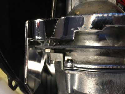

U can see the bolts and how jacked up they are the way they fit the bracket to the projector mounting flange.

The kit works and it does fit so it's not a sloppy mess. But it doesn't fit like an engineered kit should. If you go through the trouble of making a kit to fit a specific application then make it

1 - hardware included, I told them to stop sending me. #6-32 nuts and bolts....done. They sit flat too, so no issues like you are seeing there.

Oh I didn't take it as bashing. Hell......the first set of the fiberous material ones that I got, I ripped in half getting out of the film its in. Whoops.......wtf. Metal is better, but I cost savings is nice too. On these, with how flush it sits, the rigidity isn't a huge thing. I wouldn't recommend welding anything or adding to the length there of the bracket......as you see then the projector hits the shroud. no fun there.
OEM highs, thats a diode, so no biggy there. Cut that booger, use it, makes things a lot cleaner. OR.......just solder the 2 wires together with no disconnect. Bolt length? 1"
