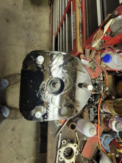

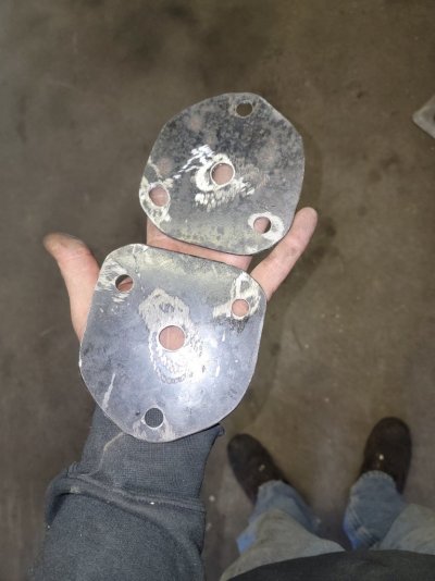

20220323_183846.jpgMy Strut bushings were squeaking like everone else is talking about, also have 2 inch lift with strut spacers. I made 2X 1/16" hardened steel plates with 1 1/8" hole in the center replicating the way the bushing is suppsed to be set in the shock tower. Installed them under the the spacer and good as new. The aren't perfect since I used a skillsaw with a metal blade and a grinder to shape them also a drill press but they work perfectly. No more squeak, it works as designed. I hope this helps anyone choosing to go a cheap route for a lift
