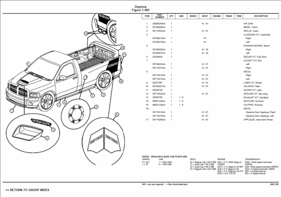

does anyone knows the original part number from the Daytona Wing? Is it possible to mount it on the Same way like the original SRT Wing on the hardcover?

Not sure what you mean by "which ET", but any 20x9 1500 wheel from 2002 to 2018 will fit your truck and clear the brakes. If you're looking for part numbers, go the DIY 3rd gen section and download the parts manual for your year. There are significant front end differences from 2005 to 2006 as well as the interiors. The major change was the jump from PCI bus to CAN bus.

You didn't look very hard....page 16.......
