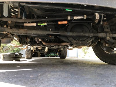

I dunno, guys........it looks to me like the Ram HD 2014+ model year trucks fixed the death wobble and wandering. I took some pics of my steering linkage. The links are close to parallel with each other and horizontal - none at upward angles to the steering gear. Also, get aload of the steering gear box attachment to the driver side frame rail - a welded box bracket. Furthermore, there are TWO frame rail cross members just behind the steering gear box.
I can't see how such a frame could be much stiffer and less steering wobbly. 2017 Ram 2500 Steering Linkage.jpeg
