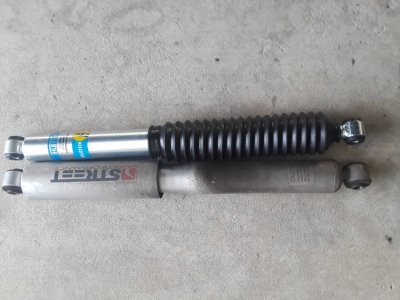

If your staying 2/4 then do the following...
-Get the $300 Belltech spring only kit(dont get the kit w/ the shocks, they arent the greatest. Some will say they are, they arent)
-Factory replacement Bilstein 4600 front shocks
-Bilstein 5100 rear shocks in pics below(not specific to our trucks. They are the same exact length as the Belltech shocks compressed & extended....just MUCH better. Not even in the same category)
-Illicit No Cut brackets. For me there was zero ways around not having these and keeping the lowering kit. These fix the wobble, wheel hop, pinion angle and center the axle all at the same time.
-2008 Ford f150 front sway bar endlinks to level the front bar
Start there, that is a great set up. From there if you want to play more then get a Hellwig rear sway bar, Spohn adjustable panhard and Airlift helper bags.
If you want to go 4/6 then go straight to the Inez kit.
Here are some pics of my set up

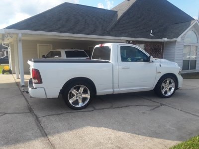

Truck looks great! Is that with the 2/4 parts you listed or is that 4/6?

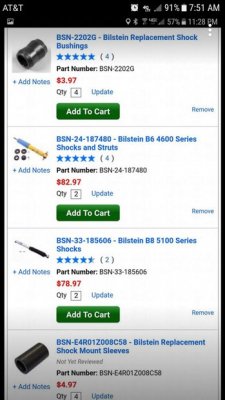

I 100% agree with this methodology......only difference for me is it was a costly evolution to get to your above conclusions.
As you know I went with the 5100 front shocks as well; which took a little customizing to get there and have yet to install the ilicit no cut brackets, so I'm still not where I want to be but hopeful to get everything done soon! and I'm probably going to switch back to stock length endlinks--see how that feels before making final decision between the F150 and stockers
Same here. I spent alot of money on parts that were suggest to me to work and they flat out didnt
