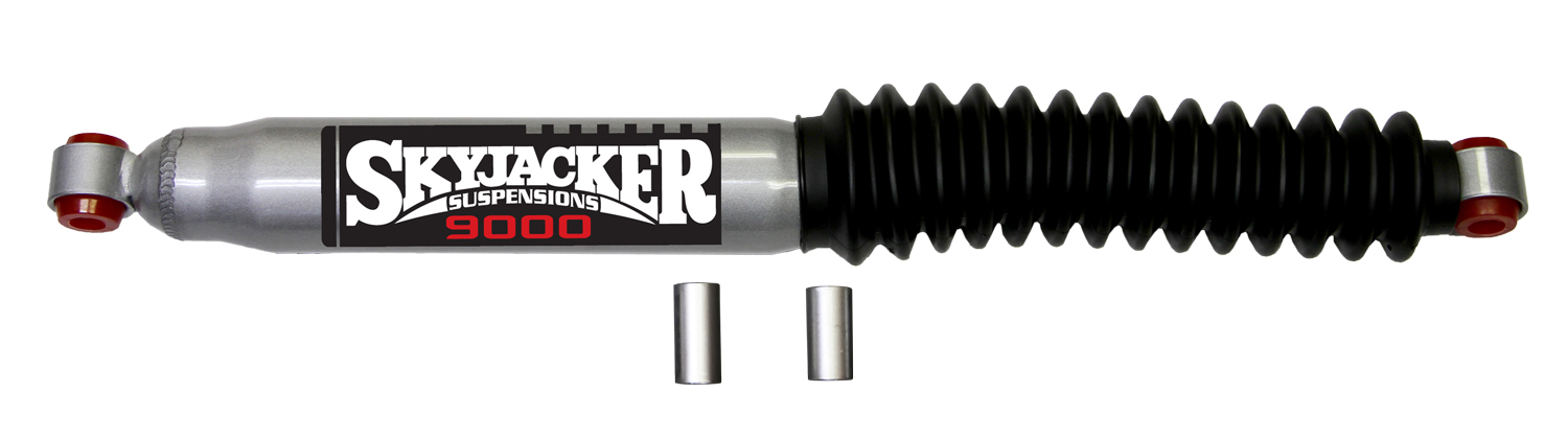

Steering Stabilizer
426power
Jul 2, 2019
81
49
BRUNSWICK, Oh
Model: 33-170794
Does anyone know if this will fit a 2018 am 2500 it shows only fits up to a 2014. They are only showing a two shock design for the 2014 and up models

I’m coming up with the same as you. Nothing indicates it will fit 2014 and up. They all show a dual set up for Bilstein. What’s odd you can find a single fox stabilizer that fits 03-21 but most are dual setup. I’m sure someone will chime in with some better info

I may buy it and measure it up extended, collapsed and stroke and just figure it out.

Interesting, if you pick 2014 on the skyjacker site it shows up as compatible. 2015 and up it does not (gas or Diesel). This is on the skyjacker site, not 4 wheel parts.
I wonder if it has anything to do with the death wobble law suit. I bet they changed all these to dual shocks to illuminate that.
