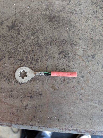

    Checked the ground connection for the harness and the connector that bolts to the rear of the factory head unit was loose inside of it's crimping and slid right off. I decided to crimp on a new connector and now the radio seems to be working. Hopefully that was the permanent fix...[​IMG]

    Thats why I don't like those crimp butt splices nothing but problems

    Hopefully that wAs your issue.....drive it a few days an update to let us know. Makes sense to me if it was a ground. Those butt connectors I've used but not a fan...it's my last choice but when I do I crimp the shit out of them....but not too much because it's easy to cut that wire or even crimp. I just prefer not to use them unless I'm backed into a corner....or just being lazy haha
