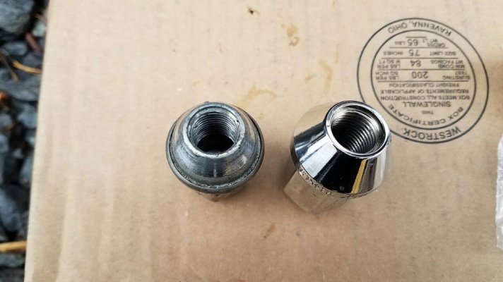

Changing these was the first thing I had to do on my 1500. Almost half of the factory ones were shot :( Replacement nut had cost me about $1/pc

Either McGard or Gorilla will be way better quality than the stock stainless sleaved garbage lugs.

After seeing this video, I realized I have the same type of lugs on my truck. So before I had to deal with getting a rounded lug off without destroying my wheel, I decided to get some Gorilla Nuts. The stock lugs have a thin metal sleeve that covers a relatively soft steel nut which rounds off way too easily.
The part number for my truck and I believe all 2013+ trucks with 20" wheels is GOR-66148DX. The specs of these are M14 x 1.50RH. These are actually cheaper than the replacement Mopar lugs.

When loosening or tightening the lugs with the sleeves, be sure to use a six point socket. The six point socket grabs the flat sides of the lug nut, not just the corners and helps to prevent rounding the lug nut.
