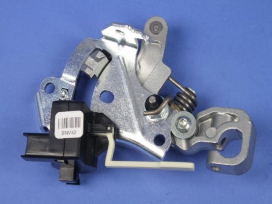

There was a recall on the BTSI. See URL Does sound like an interlock problem. You can over ride it, search youtube, a lot of info o how to over ride, though my take is, get it replaced. It was a recall described in the text of the URL. Thought the interlock problem was for failure to lock, that switch does serve multiple purposes, so Something U need to get fixed. OP, if for some reason U R driving and hit brake and it does not disengage CRUISE, do not panic, manually turn off the system using steering wheel controls.
Posts #3 and #4 does look like an area to check as ACES in 8 said, they R probably spot on. ALL IMHO...

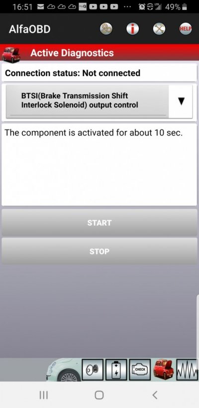

Also to add to my other post above, if you have AlphaOBD you can actuate it and see if it works. If it does work you know it is ok and more likely the switch or wiring from the switch.
