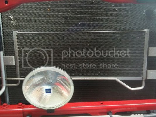

How much bigger is the 2500 cooler compaired to the 1500 with the towing package with bigger cooler?

It all depends. Dodge uses so many different coolers that one guys 1500 cooler may be bigger than another guys 2500 cooler.
Here is my 1500 "tow package" cooler-

That would be a 16 row cooler. The one out of the 03 to 04 2500s are 26 row coolers.

Hemiguy - you'll be fine with the 26 row thats all mine is. For whatever reason in the 05+ they dirched the 26 row one and dropped everyone down to the 16 row one. I guess the theory was the 26 row was cooling it off to much for the trans to function correctly in the colder climates. Also why they changed the HD cooler from the 26 row to a billet aluminum 16 or 18 row cooler.
