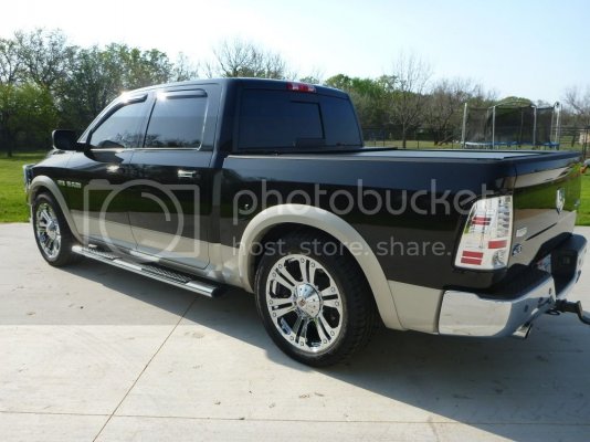

That looks really nice. I've been thinking I want to lift mine and go with bigger tires, but that's pretty sharp. I don't plan on hardcore offroading anyway. How's the ride after this kit?
It wasn't too bad at all. A little stiffer than stock. When I put the 22's on however, the ride got real bumpy due to the small tire sidewall.
