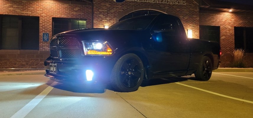

I have been through this thread a few times, but from when it started to now it seems like things have changed quite a bit. I put the 3/5 Inez kit on my 4x4 RCSB. It rides great and look great as well. But I can't help but wish it was lower. I was DM-ing Wild One and he told me he removed the front dif and cv axels, I am not opposed to this. If I want to go lower that is what I am going to have to do. Has any one put 2 in drop spindles on a truck with the 3/5 Inez kit? Will my shock be too long? Would I have a rubbing issue if I kept the stock 20x8 wheels and went with a shorter tire (255/45/20 maybe?) I feel like there is still a lot of wheel gap and if I can got down to a 5/7 why not? Let me know your thoughts.

Thanks! I do like the way it looks, and it rides fantastic. But I would like it to be a little lower so I can have a sportier size of tire on there without it looking too small.

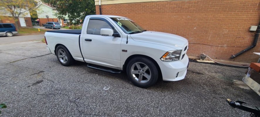

Hello everyone im new so yeah. I just installed ihc 3/5 drop for 4x4 got it aglinment and now the truck wants yo rev up randomly when im cruising. Seems like something is dragging it or making it work a littl harder. Doesnt seem to be the e brake. Might be the cv angle. Any ideas? Any aftermarket cv for this? Can i "delete" them.

I have lowered the truck another 2 inches all the way around and had to remove the CV axels. Also put new Firehawk Indy 500s on it and the tires alone dropped the frame down another 2 inches. Still rides great.

So you just drive around without the cv axles in? Is it your daily? And did you put anything in where the cv axles were?

It is not my daily. But yes I drive without the CV axles. There are sub shafts that stick out of the transfer case so there is no open hole into the case. Wild One gave me the idea after he told me he had removed his entire transfer case awhile back.

I left the transfer case in place,but removed everything ahead of it,lol.Taking the transfer case out,would entail either swapping to the 2X4 transmissions tailshaft,which is easier said then done,or else swapping in a 2 wheel drives 8 speed,along with hunting up the corresponding 2 wheel drives driveshaft. I sort of pioneered the idea several years ago,but there's quite a few 4X4's running around now with-out the front driveshaft/front diff or CV axles,mostly lowered trucks or trucks that frequent the dragstrip fairly often. Pulling everything out is usually good for roughly a 2/10's drop in your 1/4 mile times,as turning the front Diff and CV axles absorbs a bit of horsepower ,especially on a lowered truck,as the CV's run in a constant bind when you drop the front of a 4X4

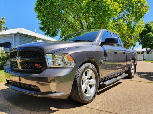

So I'm probably lower than most of you guys because I'm in Australia. I just put the Belltech 2/4 kit in mine last week, this is how it looks now. I'm looking for a way to sort out the front camber, going to try the Moog kit as I only need about 2 degrees adjustment to get it right.

Looks great. I am quite happy with the Belltech kit. I only installed the adjustable struts in the front. I was surprised how normal the truck handled.

Thanks, I actually wasnt expecting it to go as low - from the tonnes of research I did before i bought it (mostly here) I thought it would come down a bit, but not as much. The IHC kit looked good but i couldnt justify the extra cost and it wouldnt last long with the quality of roads where I am. That said, Ive never seen such a varied amount of outcomes - some guys love it, some guys hate it, some need relocation brackets and some dont. As it is I am going to need adjustable ball joints to correct a camber issue at the front but otherwise everything fitted well and is fine to drive.

I am running the front half of the Belltech kit in conjunction with the whole IHC 3/5 kit. The IHC kit can be a 5-7 inch drop in the rear depending how much you cut the rear springs, so I am sitting at 5/7 now. The Belltech is much cheaper.
