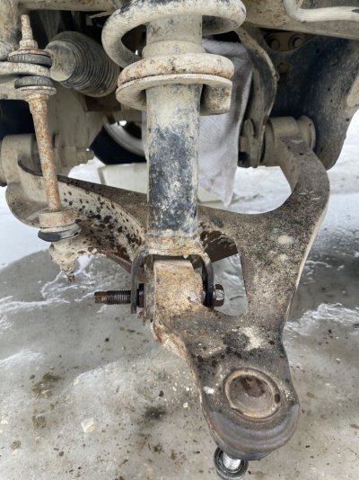

Anybody know any tricks to get the lower strut bolt out. This is a 2008 1500

Tried that, but maybe I didn’t hit it hard enough. Although I did hit it pretty hard several times. I’ll go try tomorrow if no better way turns up here. But I suppose thats all there is to do is bang the **** out of it
smoothee
Jun 6, 2012
1,334
703
St. John's, NL
Probably have to cut it out and replace the bolt and bushing. Pretty common in the rust belt especially, unfortunately. That's what I had to do after heating it/soaking it/and beating the **** out of it. The sleeve in the bushing was pretty much welded to the bolt. Coated new bolts in anti seize and haven't had a problem since

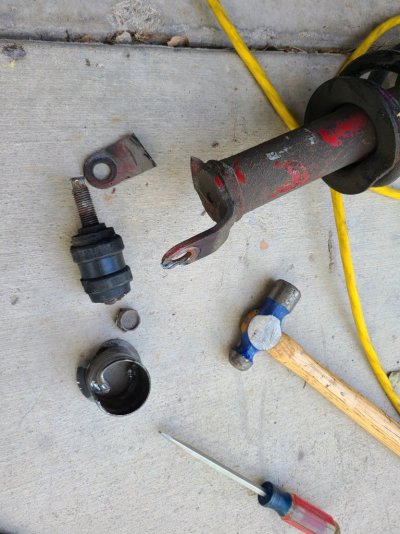

That wa so much fun.... ....knuckle breaking fun.
Bolt seized in the inner sleeve. Cut an ear off the strut and the bolt head off the other side
Once it was out, dremel and a pointed hardened grinding bit got the outer sleeve so I could drive it out.
Ball joint press almost fit, but it is in now...
Even though I bought another side, when I do that side, I will not be replacing it unless it is shot...
