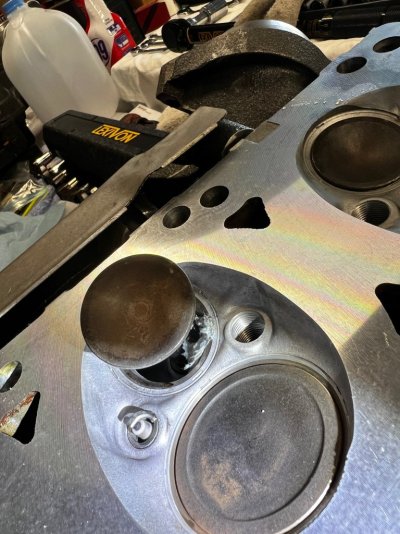

Popped the valve covers off this morning.#8 exhaust valve not moving - yep, I got that pushrod in the wrong hole. Took out the rod and it is slightly bent. So need new pushrod there. Then it ocurred to me the valve may also be bent so did a compression test and it came in at 220. Then did a leakdown and it held pressure - so no need to pull the right head! Yea, at least something went right.
Cylinder 5:
Popped the valve covers off and all valves moving as they should. Looked again using the borescope to try and find anything left in there - the intake valve is clear of all debris but I cannot see the exhaust. So, I brought it around to the cylinder 5 valve overlap and I lit a small fire in the cylinder to try and burn up any left over piece of paper towel. Still only has 25 Lbs of compression. That head has to come off and probably the valves replaced on cylinder 5..
Parts on order, I am taking abreak. We have a hurricane coming and I did not want the motor opened up for several days. I will wait till I get parts and the hurricane passses then dive back in.
At least it is only 1 head.

Thanks man! I am over it. Stuff happens. I've been around engines and cars since high school. Did a full fram off restoration of a 1970 GTO Judge 25 years ago. Eventually sold that car (should have kept it). My point is I am not foreign to engine assembly. It was a simple oversight by a tired old guy trying to get his truck back together.
At least it is only one head. I got 200+ PSI in all the other cylinders. I have a spring compressor left over from back in the day.
I think a good topic/thread here on the forums would be "Stupid Mistakes I have Made", maybe a sticky! Would be fun reading.
I'll pull the head, lap the two valves and pop it back on. I can do that in a day along with getting the intake back on. Probably have it running on Saturday. Going to rain through tomorrow so time for a break.

Finished everything this morning. It started right up. Cold oil pressure at ~ 60 Lbs with that Melling HV pump and 5W-30 Mobil1 oil. Lifter tick immediately went away in less than a minute, although I did pre-primt the system with 2 quarts.
Took it for a test drive and she is running like a new Swiss watch. No error codes, no check engine light.
Thanks for everyones time and comments and suggestions. I am just glad it is done!
