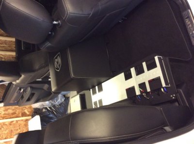

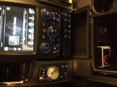

I'm gonna shoot you some pics of my setup. It's not as difficult as some people make it out to be. With a little patience and planning you can do a really nice setup in your truck. I keep my factory head unit as you can see. You can add a really nice system to your truck and keep your dash looking factory.
