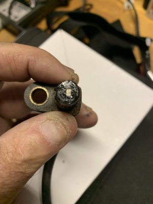

Attached are pics of the old sensor head. It is very oily. Most likely the culprit to its failure.
