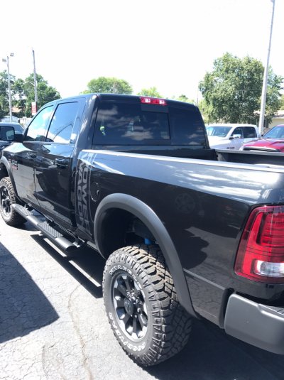

Installed a set of rear sumo helper springs from etrailer tonight to prevent excessive sag when pulling about 5,000 lbs of boat and trailer.
Can't tell from the pic but there is about an inch of space between the rubber spring and the axle unloaded.
The instructions say to put the truck on a lift to unweight the rear... pffft, hello power wagon, no need for that.
I would assume that this would severely limit radical off road articulation of the rear axle when the sway bars are disconnected. Anyone have any experience with this?
Loving the new truck.

How much did the truck sag with that light trailer before adding those?

This was done in anticipation of sag. I'm road tripping now to get the boat. But, with 4 adults in the cab and luggage (about 1,000 lbs) in the back the helper springs are just barely touching the axle... so dropped almost an inch so far.
The truck feels much better with this extra weight, rear drop and the helper springs.
I'll report back the actual sag with the boat.

I do think it will limit axle travel but these helper springs feel like a big tough sponge and can compress up to 80%.
I rarely get in a spot that requires me to disconnect the sway bars in Wisconsin... Moab, yes.
This part literally would take no more than 10 minutes to swap out with the stock rubber stop.

So, when I first installed the helper springs I had almost an inch of free space between the rubber and axle. After going about 1500 miles on the new truck with 4 passengers and luggage in the back it settled to just barely touching the axle with no weight on the truck. I guess the new truck suspension just settled a bit.
We added the boat which I think might have a tongue weight of ~250 lbs (less than I expected) and the helper springs just barely firmly pressed the axle, maybe 1/2 inch drop at best. The helper springs are progressive so I felt like the ride height was spot on and there was no bouncing or harshness to the ride. We added about 500lbs of luggage and an outboard motor to the back with no additional sag. When I step on the tongue to get in the back of the truck it doesn't sag at all... that's another 250 lbs.
I'm happy with them for my use and don't have to worry about my headlights riding up with the loads I will be carrying. I feel like it could take a lot more weight and keep the truck level.
