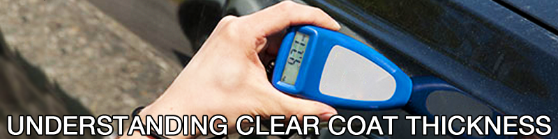

HOW MUCH PAINT IS ON A NEW CAR?
The amount of paint thickness on a car can vary greatly depending on the make/model, it can even vary from panel to panel on the same car. On average most cars will arrive from the factory with somewhere around 5 to 6 mil of total coating thickness. This is the total amount of paint (base and clear) on the panels.
You can verify this or get a more precise measurement for your exact car by using a paint thickness gauge. They can be found for as little as $150 online, but be aware that lower cost meters will only register thickness readings on steel panels - so aluminum, plastic, carbon fiber, fiber glass, and similar surfaces won't be able to be read. Meters that can read these other (non-ferrous) materials tend to be much more expensive.
Now, of that total 5 to 6 mil surface coating my experience, as well as corroborating info from other respected sources puts the portion of that total coating attributed to clear coat at around 1.5 - 2 mil of the total. If we assume the high sides on the averages that gives us the following breakdown of the paint on the average car when new:
So exactly how thin is 50.8 microns of clear coat? To put it into perspective the average piece of copy paper comes in at a thickness of around 100 microns, so your cars clear coat is just about exactly half the thickness of a sheet of paper! Seems awfully thin right? Easy to see how someone could be intimidated by the prospect of rubbing abrasive polishes and pads on something so thin, but as you'll see in the next section the amounts of material removed in correction are actually a small percentage of the total.
