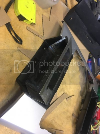

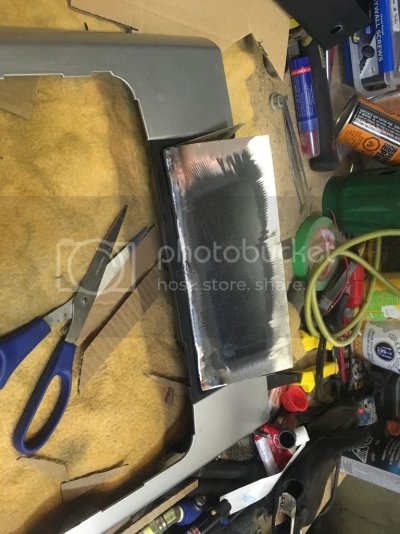

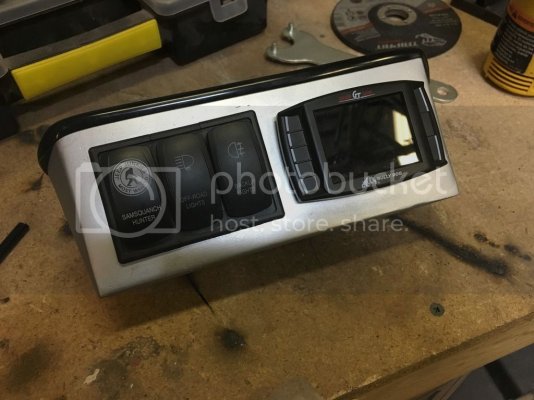

Finally had some more time to work on my DIY Pod. Custom fabbed this to fit in my forward cubby hole.
used body filler and glazing putty to get a smooth surface after welding it all together and then painted it the metallic finish.

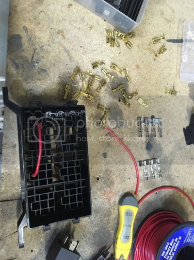

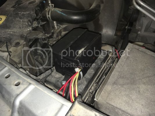

I used a DIY Relay box I got on Amazon. has 6 fuse terminals, 1 - 4 blade relay ports and 5 - 5 pin relay ports.

Are you going to update your profile some day?
That truck in the pics doesn't look like an '89. :)
Nice work on the pod!
