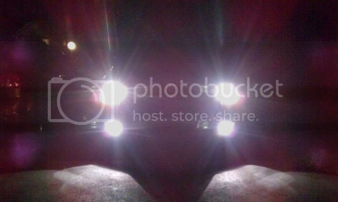

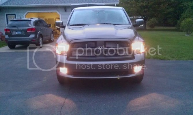

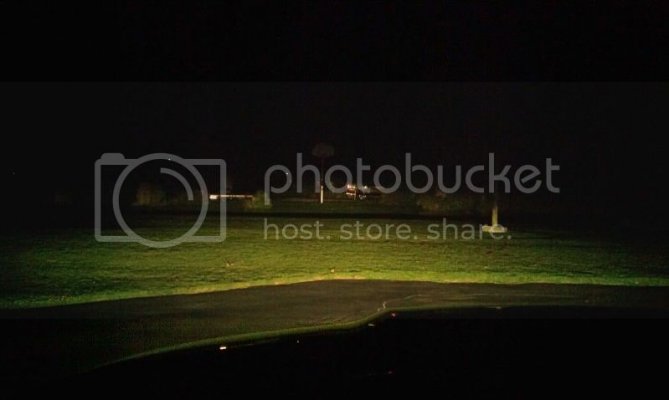

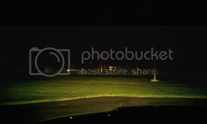

Life is about 80% compared to a standard bulb and the ultras are like 60-70%. Much brighter than standard bulbs so well worth it IMO. Ill snap some night pics tomorrow evening.

that's much better than stock. the stock bulbs were just one step above a candle

so over all, like them better?

I had them in my previous GMC so I knew I would be happy with them and now that the Ram has them Im very pleased!!! I always use the regular Silverstars since Im not much for the super blue appearance, I prefer a nice clean and crisp super bright white light output. If you want more blue then try the new Silverstar ZXE bulbs which are a bright blue.
