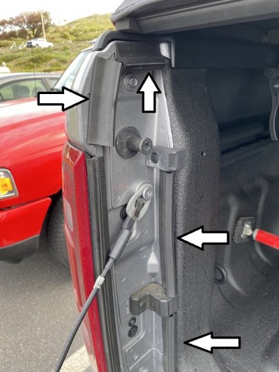

Sup guys,
What creative way should I seal this crazy gap. Beyond the plastic it looks like it’s about 3/4” gap on both sides at the top and 1/2” the rest of the way down.
See some different weather stripping kits But I’m more worried about the top for rain. Just slapped a cheap tonneau cover on for now as my cap is 12 weeks out.

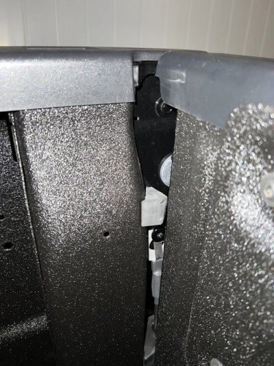

Pic from the inside

It’s same on both sides. Gate closes and opens fine. Idk didn’t think it’s messed up just trying to figure out best way to go about sealing it all up

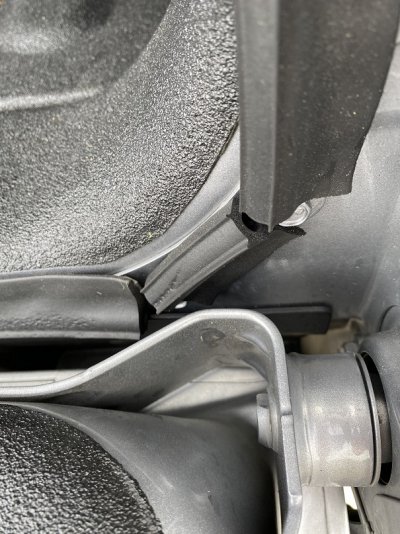

I got the ESI Ultimate Tailgate Seal with Taper Seal 10ft for use with Truck Caps and Tonneau Covers from Amazon and installed it yesterday. It rained today and bed was dry!

I like the curve you did at the top. The seal I had was not pliable enough to make that bend.
Trying to figure out positioning of the same seal you have in your pic. Directions kind of suck and not any videos for Rams that I could find. Any tips or advice? Did to use the 14" wide piece for the curve at the top? Not sure of the year of your truck but mine is a 2025 and looks similar in tailgate setup. Thanks

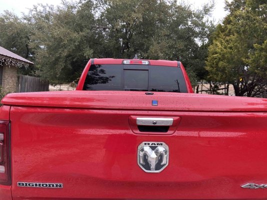

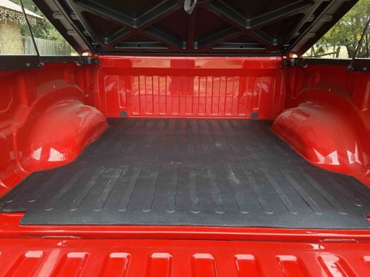

Guess I am lucky. I get very little water intrusion, but I do have a Full Mopar Tonneau cover and the back end goes over the tailgate. I get a lil water from the gate area but not a lot at all. I only get water entry from sides or front if I do high pressure spray directly up at the edges, so does well even in monster rain storm as water not normally splash that way. Guess I could seal the back gate a lil, may need to look into suggestions here just for the gate.
ADDED: If I have to move anything big, got my stock trailer. To remove the cover to get stuff is a 2 person job. Cover wide, unwieldy, not happy but requires 2 people to put on/take off and just me here. SO I use my stock trailer to get any big items.
