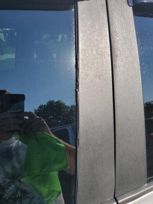

Anyone have this happening? It looks like it's a tape that can be replaced. Will this cause any problems like rust?

The black vinyl looks like crap & peels off after a while im thinking of taking mine off or installing putco black platinum pillar posts

Mine is an 09 and I cannot get that crap off. Heat gun helps but the glue is years old. Any other suggestions?

Maybe a 3M rubber eraser wheel?
I know they're recommended for adhesive removal after de-badging.
My 2010 came off with some effort & a Harbor Freight heat gun, I had to get it hot enough to soften & needed gloves to grab & tear it.

Maybe a wallpaper steamer. Rented one to take interior window tinting off. If you get a layer of steam trapped under it working slowly from the bottom up it takes it right off, adhesive and all.

Try bug and tar remover for any of the glue that gets left on.

I know my wife uses goo gone to remove glue from new windows after they take off the plastic

I've had good luck with goo gone also.

Mine is an 09 and I cannot get that crap off. Heat gun helps but the glue is years old. Any other suggestions? There is a decal eraser you put on a drill and wd40 works great for removing the glue also thats how i did my last ram hope this helps

Goo gone isnt to kind to the paint... at least wasnt on mine.
+1 for the eraser wheel, works like a charm

I let my truck sit in the sun on a hot day and it came right off super easy.

Yep remove it or buy a roll of 3m stain black or matte vinyl and wrap it

I had that problem with my 2015 and the dealer said that was normal and that they would put another one on under warranty. I told them to just take them off and call it a day but they told me that they had to replace in order to be under warranty. After showing them the stupidity of their ways, they removed and polished and billed Chrysler for the the new ones that were unused.
Under them is the body color finished. Dumb thing to put on there
