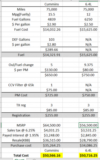

I got my Cummins because I wanted one, not necessarily because I needed one. The 6.4L could have towed what I towed, but I wanted a Cummins and didn't care about the cost at the time. It wasn't until later when I did the math that I found out that the Cummins was actually cheaper for me in the long run if I account for depreciation. Here are my numbers.
Your numbers may be different depending on fuel prices in your area, the interest rate of your loan, used truck values in your area, and other variables so I would recommend doing the math yourself if cost is your concern. The PM's for the diesel do cost more, but they are at a 15k mile interval instead of a 8k mile interval so it costs about the same in the long run.
If you want to know what the cost pr miles based on price and mileage, here is a chart I made a long time ago for work. Basically, the cost difference has to be about $.70 between the two to be at the same cost per mile. DEF adds about $.001 per mile.
