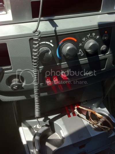

I think it'll look fine, just depends on where you mount it and the color choice you go with. I also hooked mine up to a switch inside the cab so I can leave it on and just flip the switch on and off to make it turn on and off outside the cab.

The two lines that go from it are (+) and (-). Basically, I ran a wire from battery to the switch, and then switch to the LED bar, and then just did the (-) wire normally. I'll get a pic in a second, the switches still need to be cleaned up from the halo install, but I'll show ya :p
