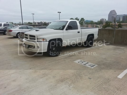

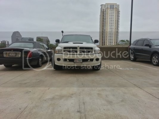

Also no track tonight starting to look like rain is a possibiliy. Did take the truck out to get detailed inside and out.
