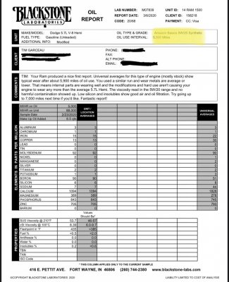

How long does Blackstone typically take for a reply to a gas engine oil analysis? Also curious on how many consumer samples they test per day.
Might just give them a ring or email tomorrow...

Have you sent your mix into Blackstone for a uoa? It might be interesting to see. BTW mixing isn't just about additives.... Different oils will have different viscosities and tbn values. Could be interesting to see how they all interact with each other.

Look at the links they provide the Virgin Oil Analysis from Blackstone.
Then you add up the mix of oil in proportion to the quarts used and divide by 7. That gives you the per qt analysis.

Blackstone does not brake down the different types of Moly. Look at the reports.
I know they dont. The manufacturers dont, either, because "trade secret". We can only assume, so even math cant help you there.
Are different types of moly compatible with each other? Do they react negatively? Does one negate the other? No idea.
But a UOA of the blend could give you an idea of how well everything is working together.
A VOA of it would be useful as well, to determine just how much "life" is in the oil before it starts (TBN).

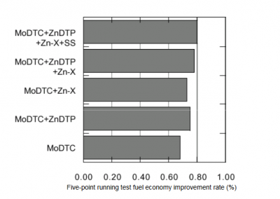

Can really only educated guess it. Infineum (the largest known maker of Tri Nuclear) is owned by Mobil and Shell.
Shell makes Pennzoil products. So its possibly in the PUP and possibly (but I doubt) in the Rotella. And now with even more Pennzoil synthetic products out, they might consider only using Tri-nuke moly in their more expensive or "boutique" oils (check out the "Hybrid engine oil", "Max Performance oil", etc)
RedLine has such a high moly count, everyone assumes its not Tri-Nuclear. If you read up on Tri Nuclear moly, its peak effectiveness is at about 100ppm or so, so RedLines moly count of 500ppm in some oils would be a complete waste to be Tri Nuclear, as the Tri-nuclear stuff is (presumably) expensive.
