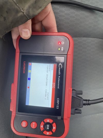

I did (finally) get some insurance money. After a few months I was able to purchase a RAM 2015 SXT. Only 90,000 KMS. I test drove it for an hour. Scanned it. Got right under it, got right in the engine bay. It seemed like a good deal. At any rate after about ten days I got a p0208, I cleared it. About an hour later I got p0308 & she was skipping around. What are the odds I just bought a lemon?

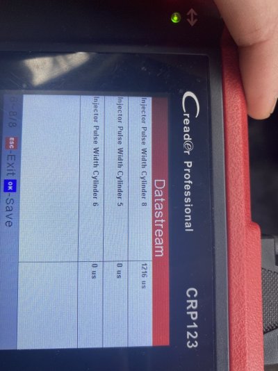

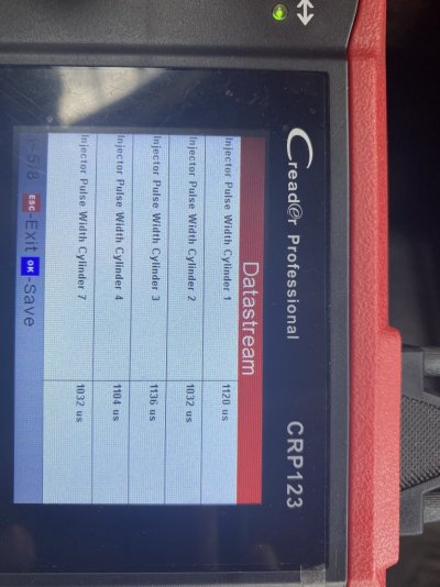

Update: when I use my scan tool I can see the pulse width of all my injectors. All of them are working about to micro seconds of each other EXCEPT cylinder 5 & 6 they are at zero

It’s not the best scan tool but it’s what I have. I pulled up all the fuel injector data I could. I reved to 2000 RPM. I am wondering why I’m getting zero micro second pulse width in cylinder 5 & 6?

I think you'll find that you were on the right path.
You're getting a misfire code (P0308) because of the P0208. This likely generated by the following:
1. Fuel injector 8 is defective
2. Fuel injector 8 control circuit is either shorted to ground, or circuit is open or has high resistance
3. ASD relay circuit is either open, high resistance, or ASD fuse is open
4. Powertrain control module driver circuit (no output)
