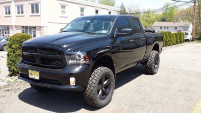

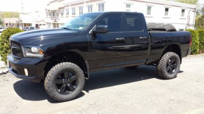

Zone Lift Installed
I figured I would add this to jcarter7's thread as I had my lift installed at the same place in NJ. I did the 6'' zone with the 5'' rear coils, along with bilstein's set at 2.1. For tires i went with general grabbers in 35x12.5r20 on stock wheels with 1.5'' wheel spacers. Truck rides better than stock and it hasn't even been aligned yet. Bringing it tomorrow for alignment. Yes i know the truck is filthy. For anyone in NJ, I highly recommend Harrington's Speed & Auto in Butler nj.
Truck looks good man. Too bad I'm leaving NJ for good in 2 weeks :( or else I'd definitely give them a shout.
