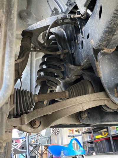

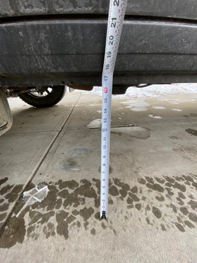

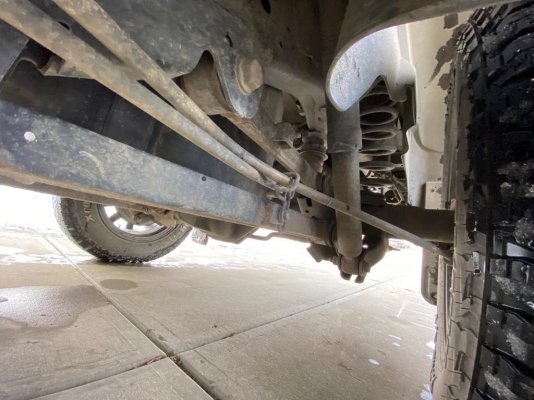

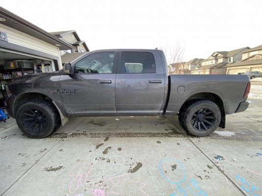

Think this Ram is lifted? Just got it the other day and planning on a big build with it. Dealership I got it from used said it was factory lifted or something. Seems higher than a normal Ram for sure.

It looks leveled but I can't tell from the coilover pic. Might be some type of spacer top hat above it.
Everything else looks factory. You can see all the Mopar pentastar logos.

Yes, more likely a spacer in the front. (top of your strut). Hover your camera around the top of the struts underneath the strut tower and you’ll see them. Some will also add a smaller spacer in the rear, bottom or top of the rear coil.

Yea the half tons come with a huge rake from the factory... like over 2” higher in the rear. That truck looks damn level. Im guessing front leveling kit at minimum, possibly small spacer in the rear too.
Whatever your “big build” plans are will most likely replace any of that stuff anyway.
