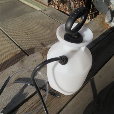

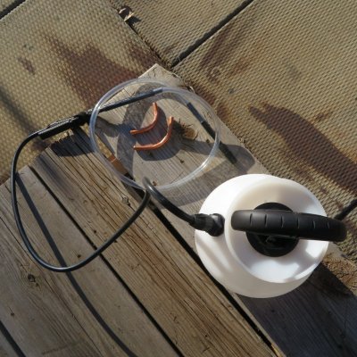

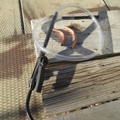

I still prefer my modded garden sprayer for filling most things.If you wanted to get really trick with it,you could add a tire valve stem and use a compressor to pressurize it to about 20 psi
