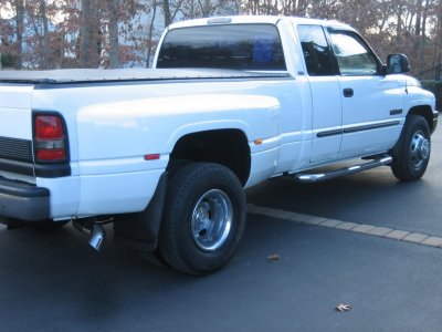

Some pictures.......she has 107K lightly used miles..not bad for a soon to be 18 yr. old truck. Pluses: No rust, clean interior, good rubber all around. no fifth wheel or goose neck
(didn't want any holes in the bed) all mechanics check out well......... Minus's: No 4wd, (but has 4:10 slip dif rear), no power seats or power mirrors....need to change my avatar!
