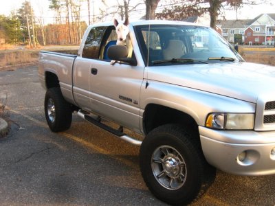

I removed the stock 16" rims & tires and replaced with Hummer rims and larger tires

There is part of your problem. Your effective gear ratio was changed along with a heavier wheel & tire.
The trucks "before and after" the tire size change really had no impact on the towing (lack) of muscle..........it sucked before and still sucks now!
