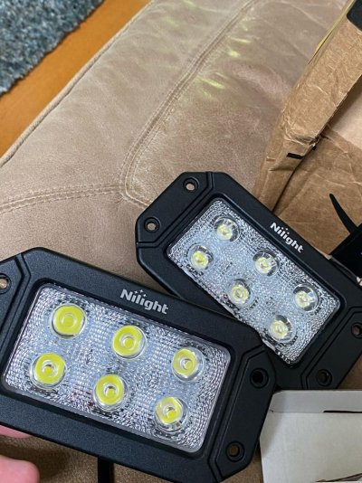

Throwing these in the bumper this weekend and doing some cosmetic fixes

For how cheap their products are, I’ve had super good luck with Nilight products. I like to put a bead of silicone around the wire grommet just in case but that’s it. I had the cube flush mounts in my Titan so I figured I’d give these rectangle ones a shot. Kinda like the looks of them. I’ll be repainting the whole bumper after some cosmetics along with the black bezel for these.

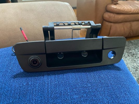

This came in early too! We getting all the goodies in this weekend

I almost did those Niight too, then found a deal on the small Rigids...but heard good things about those light...will be bright!!
How you hooking them up?
Looked at the Curt pigtail for bumper plug?

The ones I had in my Titan were great and I need that because my windows are a bit too dark at night lol. But I was actually just looking up the best way to do it. I was thinking straight into reverse lights at first but I don’t want to cause any issues as the backup camera is gonna be hooked into that for sure so I was thinking the 7 pin was gonna my best option

That was my plan for when I install some reverse cubes, use the Curt 7 pin adapter reverse wire to trigger a relay using the 7 pin positive for power. Also plan to run a switch off that relay to allow a manual activation for campsite use or whatever. Probably tie the whole thing together with a switch to add bed lighting at the same time.
